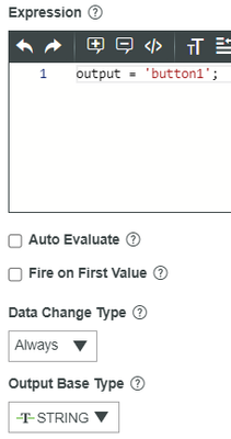

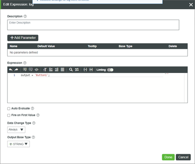

The only thing I could come up with would be to use expressions in order to give your button presses a value.
Something like this:
And then you bind your button clicked event to this expression and then the output of the expression to your service.
This way each time you press the button you will get your value into your service.
And I do think you could use the "changed" event on the expression to trigger your service:
However I have not tested this to make sure it will always trigger, as in this case the value of the expression might never change.
So you'd have to test this to make sure it works as expected.
Jens

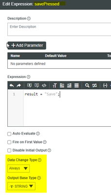

Harini_Satish
(To:jensc)
Hi Jens,
I am doing it a same way now, but the issue is it not evaluating the expressing always on click.
Not sure why
I am calling an expression for each buttons and setting one hidden checkbox to true and passing this value to one more expression and identifying the clicked event.
please see the images below for reference

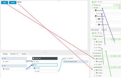

I think you are on the right track, and it would probably be possible to do it with checkboxes.
The difficult thing would be to reset the checkboxes after the button has been pressed, unless you use the "ServiceInvokeCompleted" event.
Here is a better eplanation of how I did it;
I have two buttons;
I will only explain one of them as it the second button use the exact same bindings;
The button click event gets fired and evaluates the expression.
The expression just outputs the name of the button:
That value then goes into an event router:

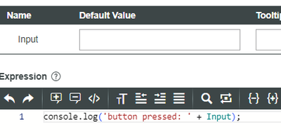

Which in turn (for testing purposes) goes into another expression.
The expression just logs the value that we input into it.
When pressing the buttons I get this log:
So as you can see, it gives me different values depending on what I press.
I am not sure if this is the best way to do this. So if anyone else has any ideas I'd be happy to hear them as well.
Jens

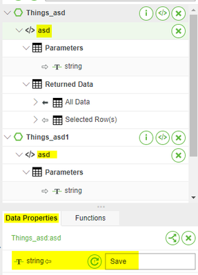

Intresting problem. I have 2 ideas:
1. is also using Expressions and then an EventRouter to route the "Save"/"Cancel" parameter to the TWX service and also executes it
This will call the service "asd" with parameter "Save" or "Cancel" depending on the button pressed.

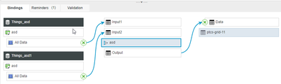

2. Not tried: You may add the service you want to call twice to the mashup, with hardcoded parameter value.
One service you call on Click of  "save", the other on "cancel". To bind the "latest" response of the last service call you also use a "EventRouter" widget which you bind both results (of both services) as input and output the Grid
But this may be the 'easiest' if it works fine with the infotables.
