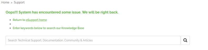

Hi @knagata ,
Not able to find the article:
Shashi.
Shashi Preetham,
+91 8099838001 | shashi@psptechhub.com,
PSPTechHub  ||  World of PTC Thingworx  ||  LinkedIn
Hi @pshashipreetham
I updated the link in @knagata's post and it appears to be working now.
