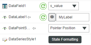

according to the PTC instructions, the number of records must be fixed. Then you can adjust the labels according to the number.
Set the property "NumberOfSeries" for this.
After that, depending on your number, further options appear, like the DataLabelN.

Hi ,This  9.3 feature i think, i am using 9.1
