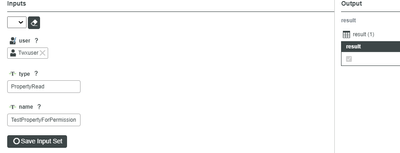

I found now that there is a service on CollectionFunctions -> CheckPermissionForUser
but it returns a boolean, and is not clear the function of parameters
// result: BOOLEAN
var result = Resources["CollectionFunctions"].CheckPermissionForUser({
name: undefined /* STRING */,
type: undefined /* STRING */,
user: undefined /* USERNAME */
May be "name" is entity name , and "type" is the specific permission to check (visibility ... runtume execution...) ?
The service never gives error codes...
Hi @iguerra
"Check Permission for User" service is used to check if any entity has a specific runtime permission for a specific user
Parameters:
Output : Boolean
Toolika Dixit
Name is "entity name" or a property/service/event name...fora specific entity ?
How can I pass the entity name and also a sub property ?
Whatever I write on params it returns me FALSE ... do you have an example ?
My need is currently to check just visibility permission.

yes you are right. Service is executing without result and error. I just tried the same service directly from the resources in 9.1 version but hard luck. May be i can check this internally and get back to you.
Mohit
Please check below screenshot for working example of service CheckPermissionForUser(Check to see if an entity has a specific run time permission for a specific user),
Twxuser has run time PropertyRead permission for the mentioned property hence it returns true.
The valid inputs for the type parameter are (case sensitive): PropertyRead, PropertyWrite, EventSubscribe , EventInvoke, and ServiceInvoke
name - Name of the resource (i.e. property, service, event) to check

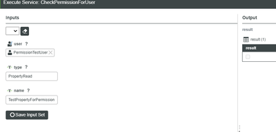

I created a new PermissionTestUser and did not provide any permissions and ran this service for the new user and it returned false.
On the name field (name of the resource), how can I define the thing name and property name ?
is it possible to check just the visibility permission for an entity ?
