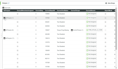

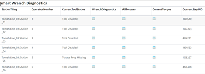

Is there a way to create an infotable on a mashup that allows to click on infotables within the infotable like you get on the Thingworx composer? When I send my data to the grid widget, I get an infotable icon that's not clickable. I would assume this is a pretty simple thing since it's used in Composer, but I can't figure it out. Any help would be appreciated.

Composer uses different widget than Mashup editor, that is why Composer can do things differently.
For your use case, not sure if it's the most elegant solution (or elegant at all), but you could put a link in there to a new mashup instead of the infotable.
Put the infotable into a session variable and have the new mashup using a grid with the data bound to that variable.

other ideas:
you do not show the columns containing the infotable in the base table. when the user selects a row the 'selected' infotables:
1. are then passed to three different grids and show the content. (so you have multiple grids in the same mashup)
2. or instead add a button "show details" to and open a popup with the three additional grids. or trigger the popup vie double click or so.
