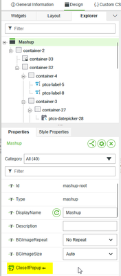

Im new to PTC Thingworx and I created a child mashup. To load it, I made it a popup of my main mashup. I put a close button inside the child mashup and wants to close the popup. Not sure how to do this, appreciate if you could help me with this.
In your popup-mashup you can bind the button click event to the mashup "CloseIfPopup" action
2 REPLIES 2
Hi @JY_11008628  , There's a checkbox in Navigation widget that's ClickOutsideToClose, thus you don't even need a Button outside the Popup, just click anywhere but inside.
