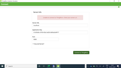

Hi Team,
I am unable to connect to on premise Thingworx8.5 (Thingworx foundation Trial for H2)using academic simulator.
please find the screenshot.
Need guidance to resolve the issue
Praveen

Hi @Praveen_GR.
Is the Academic Simulator on the same machine as ThingWorx?  If not, you can't use localhost.  You'll need to use the hostname of the ThingWorx server.
Also, did you validate that you can hit the ThingWorx url from the machine running the simulator?

Simulator and Thingworx are in the same machine.
yes I validated by accessing the thingworx url http://localhost:8079/Thingworx/Composer/index.html and it is working fine.
can we connect to on premise thingworx using academic simulator?
is steps need to connect to on premise thingworx is different from hosted thingworx?

Hi @Praveen_GR.
Your port is wrong in the config for the Academic Simulator.  You have indicated port 8080 there, but in the url you provided for ThingWorx, it's 8079.

Tried with port 8079 also but still not able to connect.
Please find the below screenshot.

Hi @Praveen_GR.
Is it possible there is a space before the port number?  When you created the appKey, which user was set up in the "User Name Reference" field--possibly a permissions issue?
After checking the above, if it's still failing, please provide the Application Log located at ....ThingworxStorage\logs\ApplicationLog.log.

Initially used the administrator in the user preference on creation of application key.
Then created a user "praveen" and created a application key with user "praveen".
Still the same issue exists.
Please find the attached  application logs.

Hi @Praveen_GR.
It looks like a permissions issue.  Try changing the "User Name Reference" back to Administrator to see if it works.

hi,
created the application key with administrator.
used the port number same as the application url localhost:8079.
below is the message displayed.
when i used the port no below message is displayed.
Praveen

Hi @Praveen_GR.
If ThingWorx is running on port 8079, there's no way port 8080 would ever work.  Please trying clearing the port field and re-entering port 8079.  It still appears there may be a space before the port number.

There is no space and also cleared the port number and entered the port number 8079.
I used the hosted(cloud) thingworx ,and was able to connect to hosted thingworx successfully.(used this one year before).
As my cloud trial version expired, used the on premise thingworx .is the steps that we follow for on premise thingworx is different from hosted thingworx(using academic simulator)?

Hi @Praveen_GR.
You should be able to connect to your local instance in the same manner.  I tested on mine and had no issue.
What version of Windows are you running?  Any security policy in place that could be affecting your connectivity?  You could try changing localhost to the name of your system, though localhost worked on mine.

Using windows 10 Home edition.
