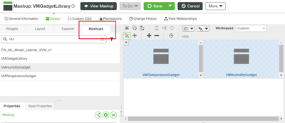

in "Task 4", after add "Contained Mashup" ( line 9 ).

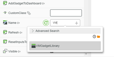

in mashup properties I can not find the created gadget as mention in the guide. ( line 13-14 )

@martinwijaya
When you click on your containedMashup in the properties section you will find a Name field with search box and you will be able to find your already created mashups there. You can also refer the following article to create dashboard with Gadgets.

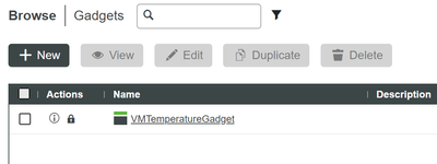

the "Gadget" that created not showing the the field "Name"
below is the Gadget
I try to search the Gadget and not found
martinwijaya
(To:martinwijaya)
I don't understand why
but I am able to add the gadget through "Mashup" tab, not using the "containedMashup".
Maybe it's bug ? or different Thingworx version

@odukiya I can also confirm that gadgets don't show up in the available list of mashups for Contained Mashup when I try to edit Name property, looks like a bug. I'm on 8.5.4-b222.
@martinwijaya, just use drag-and-drop from the Mashups tab, as you suggested -- it seems to work fine.
