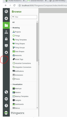

But now as my trial is expired, I am trying to rebuild my work on thenew local platfiorm. I can not import my old work so I am trying to redo it, but I can not see the ANALYTICS Section. I installed Analytics platform but I do not see it. As you see in this photo. Any guidance here will be highly apppreciated.

Hi @Ghandour
To see the Analytics icon you need to installed the ThingWorx Analytics Extension that you can find on the PTC Software Download page under product ThingWorx Analytics.
Make sure to install the extension compatible with your version of ThingWorx.
