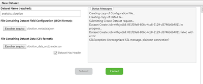

I Am testing the Analytic Trial, I make the CSV and JSON download from the developer site (analytics_vibration - https://developer.thingworx.com/resources/guides/analytics-builder-quickstart/data-upload).
I Try to create a new dataset, I choose the files and click on submit, then the error below happens.
My Analytics Server configuration is like below.
Obrigada.
Solved! Go to Solution.

Hi
Could you confirm if your ThingWorx server is using https ?
Can you upload <ThingWorxAnalyticsServer>/config/analytics-server.properties and <ThingWorxAnalyticsServer>/config/system-environment-variables.properties

How can I confirm if i use HTTP or HTTPS?
For access the Composer I use only HTTP. I am using the trial version, so it's running on DockerMachine.

Hi
Ok so you are using HTTP.
In this case in ThingWorx Analytics Builder > Settings, uncheck the box for SSL access under the Thing Name since you are not using SSL.
Then save the settings and try again

Hi
I Alredy did this and happens the same error.

Hi Christophe
I tried again without the SSL, but now I Unchecked the SSL access, restarted the server and tried again. Now it worked.
Before I did not restart the server.
