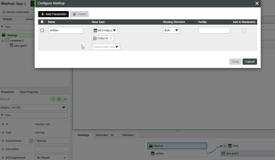

and it did render my grid which bound the entities mashup parameter:
mashup config:
Not sure if there is a more compact way for this. I dont think you can pass too much data to it via url this way...

I tested with urlencoded serialized infotable and it worked
{"dataShape":{"fieldDefinitions":{"description":{"name":"description","description":"Entity description","baseType":"STRING","ordinal":0,"aspects":{}},"name":{"name":"name","description":"Entity name","baseType":"STRING","ordinal":0,"aspects":{"isPrimaryKey":true}}}},"rows":[{"description":"world","name":"Hello"}]}
url encoded:
http://localhost/Thingworx/Runtime/index.html?mashup=Test&entities=%7B%22dataShape%22:%7B%22fieldDefinitions%22:%7B%22description%22:%7B%22name%22:%22description%22,%22description%22:%22Entity%20description%22,%22baseType%22:%22STRING%22,%22ordinal%22:0,%22aspects%22:%7B%7D%7D,%22name%22:%7B%22name%...
mashup config:
Maybe you could have some "landing" mashup which would navigate to your target mashup, passing wanted default parameters instead?

This did work, but I found for my case it was easier to send query parameters through the URL then call a query of the data in the mashup, rather than trying to push a large infotable of data through the URL.
this sounds better, indeed
