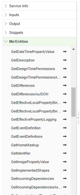

where can I find the service GetFileListingwithLinks? I can't find it either in Snippets or in Me/Entities
You will find it on a repository thing:
// result: INFOTABLE dataShape: "FileSystemFileWithLinks"
let result = Things["SystemRepository"].GetFileListingWithLinks({
path: undefined /* STRING */,
nameMask: undefined /* STRING */
