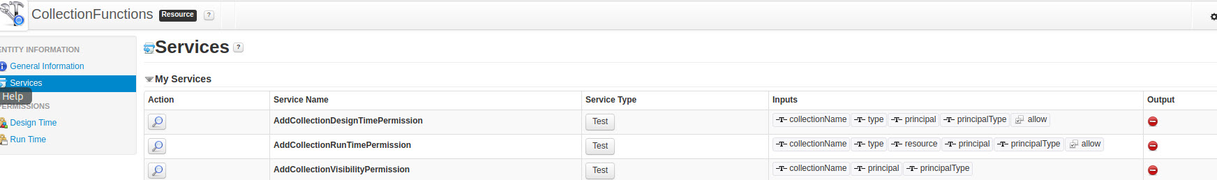

Services mentioned by you above would work if you are doing individual access permission mgmt. Since you'd likely have bunch of entities on which the user will need permission look for CollectionFunctions which is available under Resources in the Composer it contains services like
When calling them individually for e.g. i have a user "M" and to grant Visibility permission on an organisation I would do something like this from a service
var params = {
	principal: "MOrg" /* STRING */,
	principalType: "Organization" /* STRING */
// no return
Users["m"].AddVisibilityPermission(params);
