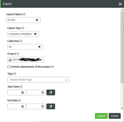

Instead of starting another topic, I would like to ask that how can I export a project from the ptcu learning server
https://ptcu-thingworx83-fundamentals.portal.ptc.io/Thingworx/logout/logout.html?locale=en.
I tried as follows but not working.
After pressing export it gives the following error.
Best Regards,
Muhammad Naeem Akhtar
