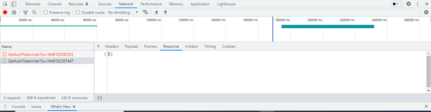

We have built an extension for GooglePubSub authentication.
This extension works in 8.5.0,9.x all versions but it is not working in 8.5.18 version of thingworx and below error is showing up.
WebSocket exception caught!, closing connection!
Exception occurred while connecting to server
Refilling connections on [endpoint 0, uri: wss://parec.ptc.com:8443/Thingworx/WS] failed : timeout waiting for websocket handshake to complete
Please help me!Thanks in advance

What was the last version of 8.5 that it was working on.  This will give us some idea of where to start looking for a change that would have resulted in this behavior.  Which versions of 9.x did you actually test against?

Have you tried using your browser Dev tools (F12) for troubleshooting?

Java service when executed from Thingworx gives empty result but expected is to generate token key
