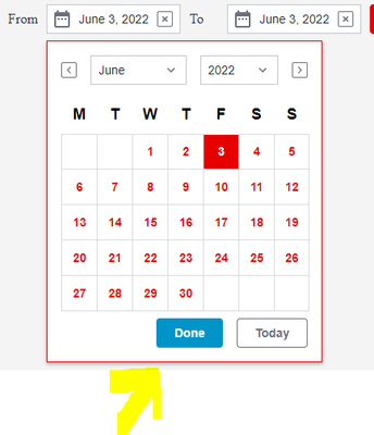

Can anyone tell me how to apply custom css to date picker widget to change the background color of the buttons inside the date container(Done & Today).
Please refer the attachment. I wanted to change the default color to red .

@JANAKIRAMAN_P : Please find attached entity for this . Basically you will have to inspect in chrome developer tools and find the element where CSS need to be applied. I have used the following CSS in the attached entity.
ptcs-datepicker-calendar::part(day){
color: red ;
