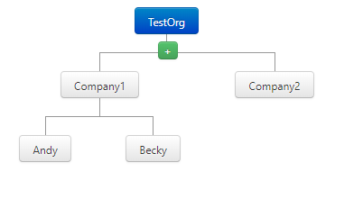

I am looking to make Dashboards and Organizations work in a way that it doesn't naturally within Thingworx. I want to have an organizational structure similar to what's shown here:
for the purposes of having a single sign-on to the mashup that will be shared across the organization. However, I also want to be able to have it so that Andy can share dashboards with Becky, but not with anyone in Company2. As far as I can tell, you can only set permissions so that they can be shared within the organization which means that if I set permissions so that Andy and Becky can see each other's, they will also be able to see everyone in Company2.
I am looking to do 1 of 2 things:
1. Make it so I can use one login to sign into multiple organizations
OR
2. Set permissions on a sub-organizational level to have dashboard sharing within the sub-organization and not the entire organization.
All help is greatly appreciated.

And/Or better if it's a multi-tenancy solution, better you set one Organization for each Company, that way you know that you won't mess around with visibility

Have you looked into making your Company A and Company B two different user groups?
