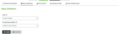

Hello!
I have a mashup with a dashboard that when I'm with an Admin account looks ok but when I log in with another user it doesn't appear in my mashup. I've already given Visibility and Run Time permission to the Org and UG this User belongs and still no change. Does someone know how can I solve this? Is there another permission type I must give?
Thank you so much in advance.
3 REPLIES 3
Check the Configuring Visibility and Permissions in Dashboards page in the HelpCenter and this case - CS301771
Do you have menus in your dashboard?
Just a wild guess - it could to be related to this issue - one have to assign relevant user group to the menu on the menu definition tab
