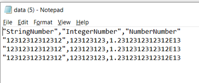

This is very strange. I just did a quick test on 9.3.5 using the out of the box export widget:
Its source data binding is this:
With the data being sent to it being:
The CSV output looks like this when NOT opened in excel:
So you are correct, it does make number variables into scientific notations.
But my string variable does return as a correct string, so that yours doesn't seems very strange to me.
I'll attach my test project so you can test it out on your platform to see if you can figure it out.

imported project you provided and tested in my environment.
It gives same result as yours if opened in notepad.
but if the .csv file is opened in excel (which is the preferred application for .csv files), it gives the wierd result again.
please see the screenshot below
1. If open in MS Excel
2. If opened in Notepad
