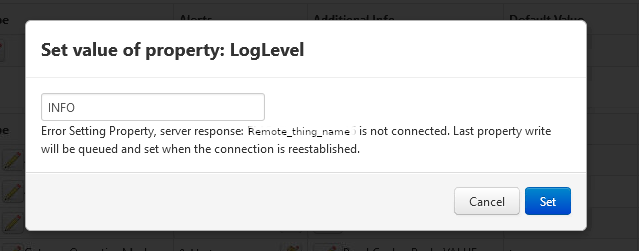

Thingworx Composer displays error message when trying to set property from Thing's properties.Looking to implement  a similiar functionality from thingworx dashboard.

I need to know if SetPropertyValues failed due to some issue on the remote thing and identify error based on service response and show custom success/error message instead of using default message.

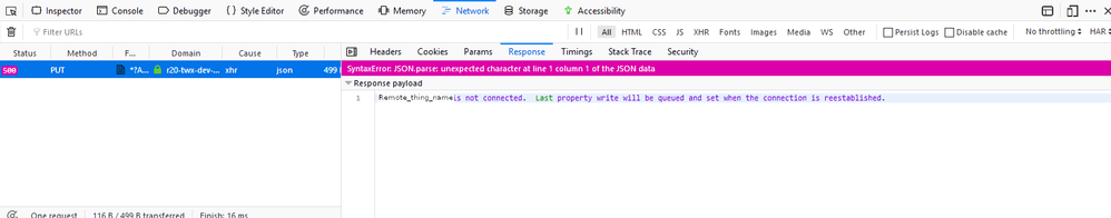

Also I am trying to call another service on SetPropertyValues service's ServiceInvokeCompleted event, which is not getting fired if SetPropertyValues fails(with 500 status code).

I have a use case where we are reading and writing values to remote thing using script handlers and if something failed during read/write, then we are returning 500 from script handler.
So checking connection status alone will not work in this case.
If we could access response for setPropertiesValues (or any other built-in service that setProperties), then I could display message accordingly.
Also,as mentioned earlier, setPropertiesValues service's ServiceInvokeCompleted is not getting fired when service fails.
