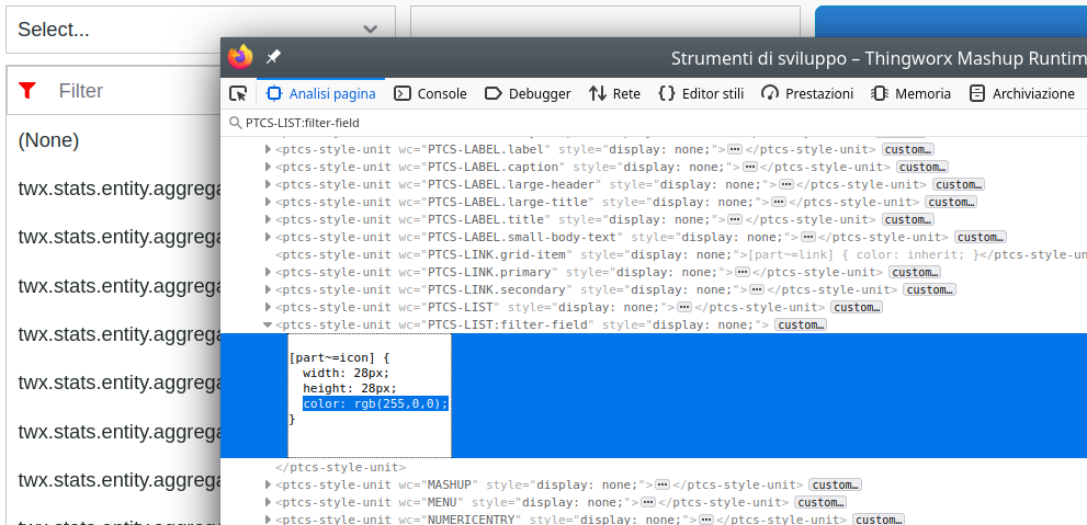

It looks like before 9.3 those selectors could be nested like this: ptcs-list::part(filter-field)::part(icon) {
But it's no more possible: http://support.ptc.com/help/thingworx/platform/r9/en/index.html#page/ThingWorx/Help/Mashup_Builder/Mashups/CustomCSSBreakingChangesToCustomCSSInThingWorx930.html#
As a matter of fact, the current W3C CSS spec mentions it explicitly:
> For example, x-panel::part(confirm-button)::part(label) never matches anything. This is because doing so would expose more structural information than is intended.
The official guide suggests those elements can be styled on the widget level via @supports (ptcs-style-unit: "...") [example] but this doesn't work for me in the CSS section within the mashup, so I guess it's only available if you are creating your own widget based on the out-of-the-box one.
I could find the style unit for this filter icon, but figuring out how to reach it via Mashup Builder is beyond me, sorry.

I thought I'd be able to use the actual full selector going from the very first element in the body, but haven't been able to get it to work either.
And as you say using the [part~=icon] doesn't seem to be possible either, this is the same selector as the small arrow in the "main" part of the dropdown as well, so doing:
@supports (ptcs-style-unit: "PTCS-DROPDOWN") {
    [part~="icon"] {
    color: red;
Sets that one instead of the filter icon.
Not sure if the "PTCS-DROPDOWN" is the correct unit though... So perhaps that would be possible to change.

I was interested in your question and found a solution. I tested this in 9.3.7
/* Change the color of the filter icon for all dropdown widgets on the mashup */
ptcs-list::part(filter-field-icon) {
   color: red;
/* Change the color of the filter icon on a specific dropdown widget on the mashup */
#root_ptcsdropdown-10-external-wc::part(filter-field-icon) {
    color: purple;
Please test this and provide an update.

Hello @PEHOWE,
This works like a charm! I guess I just didn't target the correct selector.
Thank you very much.
Jens
