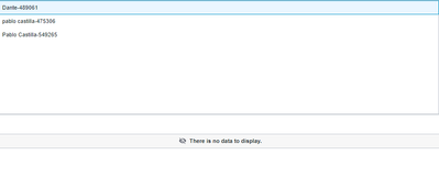

I'm designing a mashup, to gather and show data from many Things, using Dynamic Services. But it doesn't work, no data is showing in the mashup.
I've created a ThingTemplate, with all the properties needed, also, I've created a "Helper Thing" to create new things using the TT as base. The helper also fill the properties whose include some infotables.
Everithing works as should until the mashup step.

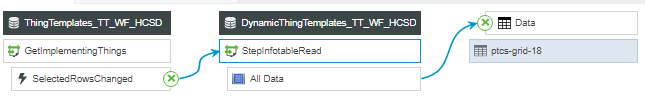

I've created a mashup with list and grids, The idea is: when I press a row, the other grids should show me the data related.
For this, I'm using services with output Infotable (IsDataTable with Datashapes and a primary key).
I've called those services on the mashup enabling Dynamic Service; Also, I've called the service getImplementingThingsWithData; all of them from the TT.
But it just doesn't work.

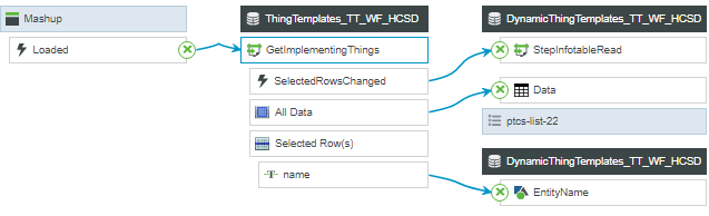

First glance things look correct.
on load get the implementing things - are you displaying those somewhere? Like a list or dropdown?
Upon someone selecting an item in that list or dropdown, the selectedrow/item will change
entity name of that row is now assigned to the 'dynamic thing template' and on that 'thing' now the service 'StepInfotableRead' is triggered
its returned data is displayed in a table widget.
Is it at all possible you are not triggering a selection?
else I would add logging and run with developer tools to see what all is actually happening.

Hi, @PaiChung,
Thank you for your response,
I've verified, but everything is binded as should. I've surrender with the "Dynamic" way.
But, I found a different way to get the results I wanted by creating a service and it works.
