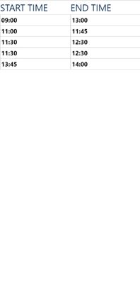

I want to know if there is any way to make the collection cells centered to the collection itself, so instead of having the cells at the top of the collection, have them centered.
Does anyone know if it is possible?

I tried using the Flex Mashup, but it yielded nothing. Currently, the collection looks like this:
Spoiler

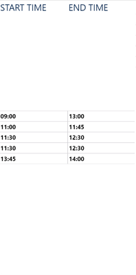

But I want it to look like this:
Spoiler

Are you really looking to separate the column headers from the data as it appears in the 2nd image?  What is your use case for this?
Also, which version of ThingWorx are you using?  I tested under 8.4.4 and the cells were centered on the screen--not at all like your images depict.

I am using 8.4.4 too. The second image was a rough sketch of what I wanted to express. I want the collection rows to fill all the available space, leaving no white space below them. I thought this would be feasible if the cells were responsive mashups, but it didn't seem to work. That's what I want to accomplish.
