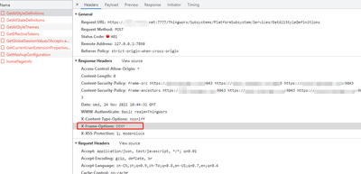

Hello, I want to a mashup embedded in an Iframe, though I added appkey parameters, thingworx still suggest I need to log in, I use the link (https://support.ptc.com/help/thingworx/platform/r9 / en/index. Html# page/ThingWorx/Help/Composer/Security/AllowingEmbeddedMashupsiniFrames HTML) method, but still doesn't work
