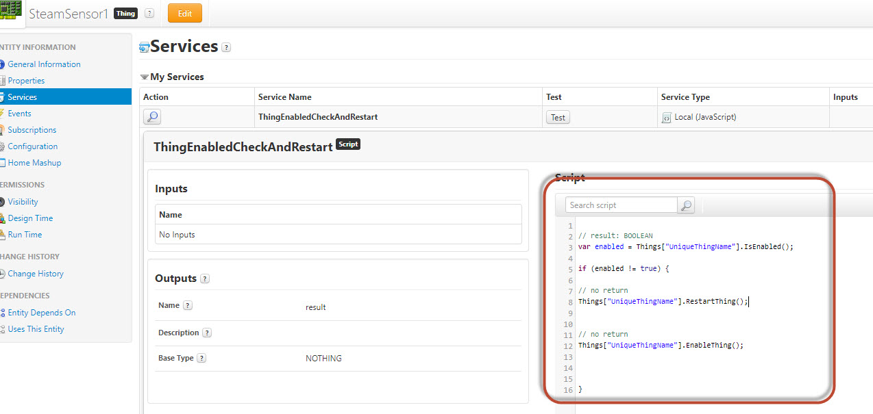

After importing the extension I get the ExtensionStandardNew ThingTemplate from which I create a thing say T2, from T2 I execute the CreateAThing
Which creates a thing called "UniqueThingName" which is disabled by default, so from a different thing i check for it and enable & restart it
This is fine.

@Sathishkumar_C In that case I think the issue might be that you are attempting start / enable of thing on template level and that's not possible. You need to attempt that on the object , something like this
@ThingworxServiceDefinition(name = "CreateAThing", description = "", category = "", isAllowOverride = false, aspects = {
			"isAsync:false" })
	@ThingworxServiceResult(name = "Result", description = "", baseType = "BOOLEAN", aspects = {})
	public void CreateAThing() throws Exception {
		_logger.trace("Entering Service: CreateAThing");
		_logger.trace("Exiting Service: CreateAThing");
		EntityServices newThingService = new EntityServices();
		String name = "UniqueThingName";
		String desc = "Static Thing from Custom Extension";
		TagCollection myTag = null;
		try {
			newThingService.CreateThing(name, desc, myTag, "ExtensionStandardNew");
		} catch (Exception e) {
			System.out.println("Failed to create Thing");
			e.printStackTrace();
		Thing mything = (Thing) EntityUtilities.findEntity(name, ThingworxRelationshipTypes.Thing);
		_logger.trace("Failed to find thing", mything.getName());
		try {
			mything.EnableThing();
			System.out.println("Failed to enable thing" + mything.getName());
Working fine.
Thanks.
