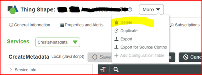

I'm deploying Thingworx entities as an git extension from Dev to test server, which makes entities non-editable.
i.e xml of entity will have new tag as <aspect.isExtension="true">.
As well as DELETE option is disabled.
I have already tried removing this tag and save xml and re-import but no luck.
How to revert or make that entity editable again?

I tried below steps but Entity is still non-editable and delete option is disabled.
1. Exported the ThingShape xml.
2. Added aspect.IsEditableExtensionObject="true"
3. Save it.
4. Import back this ThingShape to Composer.
I'm good if I get the DELETE option working even. I can delete it and create again.
Thingshape definition attached for reference.

I am not sure I understand your goal. If you want to make a "Thing Shape" editable after it has been imported as part of an extension you need to add ' aspect.isEditableExtensionObject="true" ' to the "<ThingShape ....>" tag.
Adding this tag will not allow the ThingShape to be deleted because it is part of the Extension. You will be able to edit the ThingShape. When you remove the extension the ThingShape will be removed.
If your goal is to be able to remove a ThingShape I believe it will be necessary to import the ThingShape without it being part of an extension.

I tried adding ' aspect.isEditableExtensionObject="true" ' to the "<ThingShape ....>" tag. but didn't work.
I want to achieve either of the below.
1. Make entity Editable again.
2. Delete entity.
Any idea if I delete the Entity from postgres DB directly, will it impact my application?
Note: I want to do above activities on Dev server.
