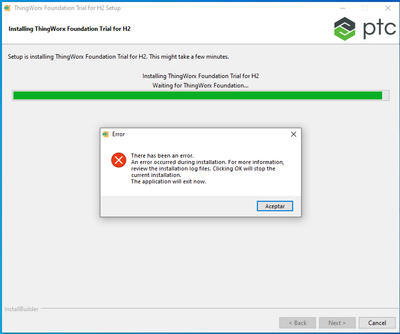

I'm trying to install Foundation 9.1 trial, with no success. I have checked the Java version,it's OK. The installer goes on untill step 3, without problem. I can even see the installer creates the folders for the program, but then I receive a message error, telling that the installation failed, and the application will exit. And all the new folders disappear.

Sorry, but still didn't arrive to the end on the installation. I dowloaded the JDK and wrote the environment variables. I attach the log for this new trial.

In case this could help, the last error screen that I get now is the one attached. The point is that, even before pressing "Aceptar", the log file has been erased by the installer.

Yes, there was some issue about language settings. Finally, I changed the Windows language to US English, and the installation has run correctly until the end. The application is working!
