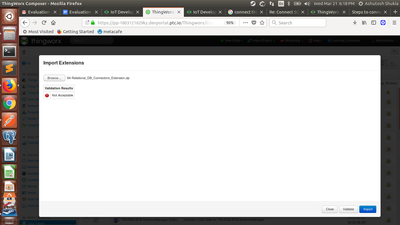

I've downloaded the Relational Database Connectors Extension from the marketplace but while importing it in Thingworx Composer I get 'Not Acceptable' validation error. The extension downloads a zip file which has separate zip files for each type of DBs.TA_rdExt_error.pngHelp.
One potential issue is that if you have for example the Postgres version of Thingworx, that extension is already installed.
I recommend taking the extensions out of the zip and then importing them individually
