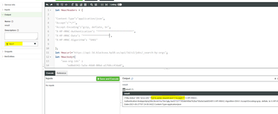

Hello Experts,
I  am using the PostJSON of ContentLoaderFunctions to retrieve some data form 3rd party application and i have this error as output:
"error-info": "Fail to parse request json",
"http-status": 400
below the code of my snippet:
let HmacHeaders = {
'Content-Type':'application/json',
'Accept':'*/*',
'Accept-Encoding':'gzip, deflate, br',
'X-HP-HMAC-Authentication': '****************************************************',
'X-HP-HMAC-Date': '2021-05-26T12:31:19.292Z',
'X-HP-HMAC-Algorithm': 'SHA1',
let Hmacurl="https://*************************/api/3d/v2/jobs/_search-by-orgs";
let Hmacbody={
"aaa-org-ids" :
"start" : "2021-05-03",
"end" : "2021-05-09",
"active" : "false"
let params = {
headers: HmacHeaders /* JSON */,
url: Hmacurl /* STRING */,
body:Hmacbody
// result: JSON
let result = Resources["ContentLoaderFunctions"].PostJSON(params);
and as output i have while i am expecting data in JSON format:
"headers": {
"Accept": "*/*",
"X-HP-HMAC-Authentication": "***************************************************",
"X-HP-HMAC-Algorithm": "SHA1",
"Accept-Encoding": "gzip, deflate, br",
"X-HP-HMAC-Date": "2021-05-26T12:31:19.292Z",
"Content-Type": "application/json"
"http-status": 400
Thanks in advance,
YD_9850038

@YD_9850038 ,
It looks like you are using single quotes in the JSON. I believe you need to use Double Quote.
Also for testing purpose to get all the parameter correct POSTMAN is a very helpful tool.
Peter
YD_9850038
(To:PEHOWE)
I changed to double qoute but still receiving the same error.
I have validated the request with postmanbefore moving to implement it in thingworx service, so with postman it works fine:
Youssef

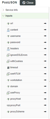

YD_9850038
(To:mgoel)
Hello Guys,
@PEHOWE i had same error with your code.
@mgoel i had the same error:
I have observed that when i delete "Content-Type":"application/json" from the json, it returns anther error:
Yous

@PEHOWE
the main root cause is body should be replaced by content independently if the json is one line or several.
if change body that i have in the code i posted in previous comments by content then it works fine!!!!
For me it should be Body and not content?
PEHOWE
(To:YD_9850038)
@YD_9850038 ,
Thank you for responding. I think I understand what you changed
The original code you used:
params = {
body:Hmacbody
The code which worked:
params = {
content:Hmacbody
If you look at the parameters to the function PostJSON:
There is no body parameter which is accepted by the function.
