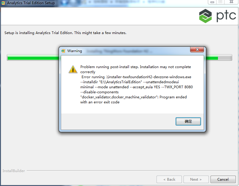

hello:
i tried sereval days to install the AnalyticsTrialEdition but failed a number of times.
i work on win 7, and i use docker toolbox.
it will occur this when installing ThingworxFoundationH2

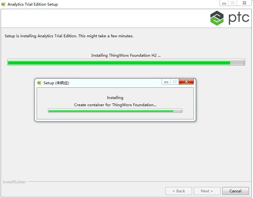

and sometimes it stuck in creating container like this
i attach this issue to setting of docker.i think i should have docker configurated but i didn't.
Please help

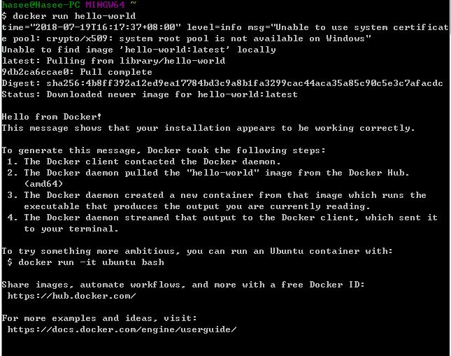

Could you ensure that docker run hello-world return the expected result.

after this is the result that docker run hello-world return,which i think it an expected one.
as for those Chinese characters, i failed to transfer the system language to English, and they mean no response from the program.when i meet this,the installation won't go ahead and i have to close it via task manager.

Can you tel how much RAM and processors this machine has got ?
The log indicate that the Foundation container did not mange to start within 5 min, so we seem to have an overloaded machine.

this machine has 4G RAM and double processor
will it too less to conduct an analytics project?
Kind regards
Minnan
cmorfin
(To:MinNan)
Hi Minnan
Yes this is too small and this is likely the reason of the failure as it takes too long to start.
The ThingWorx Analytics Trial Edition Guide has got a pre-requisite chapters that list the requirement in term of os browser and hardware.
For hardware it reads:
Hardware
The Analytics Trial Edition installation requires the following for all operating
systems:
• 15 GB of disk space
• Recent desktop or laptop system with a minimum of 4 CPU cores
• 16 GB internal memory, minimum, 32 GB, recommended
So 4Gb is indeed way too small to move forward.

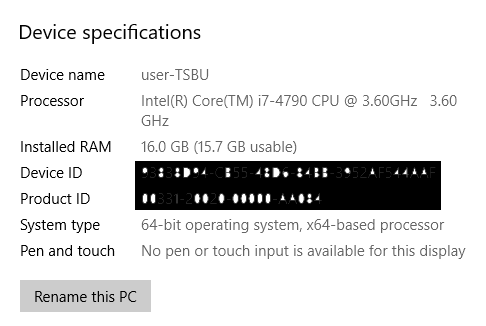

I faced the very same issue on Windows 10 + Docker for Windows [Version 18.03.1-ce-win65 (17513)] !
Machine spec as such
The complete log for your reference is attached below...
Any solution to this situation?
Sean

Hi Sean
Your issue is very different form Minnan's .
The UI might display similar error but your logs show the installation goes much further.
It is best if we do not mix different problem int he same thread, so I would advise you open a new thread.
However before doing this, double check that the docker settings have enough memory allocated (at least 5Gb). See  https://www.ptc.com/en/support/article?n=CS252454 for the steps on windows 10.
Hope this helps
