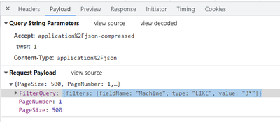

I have kind of tested this before, but ran it again just to make sure.
My service looks like this:
Running this with this input:
The input I get from the payload in F12:
This still gives me the same "error".
I'm not sure, maybe the data in the payload is not correct?
I am running this on a 9.1.12 platform, so maybe this also plays a role.

Hello @TravisPickett ,
Yes, I noticed that it is not a "correct" JSON format, but I'm not sure if the "query" input type is supposed to be of "JSON" format.
The payload is what I get from using the advanced data filter:
And it does work with the query intotable function.
var param = {
	query: FilterQuery,
	t: allData
resultInfo = Resources["InfoTableFunctions"].Query(param);
So if it comes in as "almost" a JSON object, how could I check if it is empty or not?
I can't seem to use the JSON.stringify() on it, nor the .toString().
I have had another forum post in regards to JSON input variables before and was told it is a Java JSON wrapper and not a JS JSON.
Maybe this is similar?

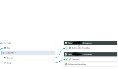

Thank you for your reply. I'll try to answer all of your points.
For what widget I am using, I am using this:
I assume it is this extension:
I am on this version of TWX:
This is the payload in Chrome developer tool:
I suppose it could be that this is just a bug in this version.
We are upgrading to a 9.3 instance soon so I will try it out again when we have migrated.
Thank you very much for your help!
