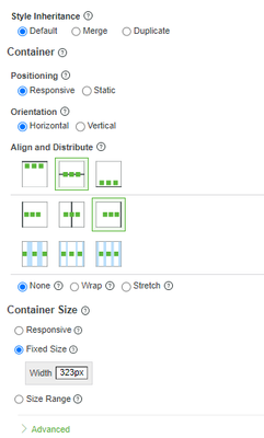

I have a situation where I have an application "header" in a mashup, like so:
As you can see, the header is not really centered.
This is due to this hidden dropdown:
At the moment I have set the container that the dropdown (and button) are in as fixed width. This is because if I set it to responsive, the application header moves around as its container is growing and shrinking.
So basically what I want to accomplish is to have the header in the center of the screen in general regardless of what happens to the other widgets.

How about adding a second similarly-fixed-width empty container to the left of your header?

One option my colleague said we could perhaps use would be to add another container to the left of the header which is the same size as the one to the right of the header.
This will cause the header container to be centered and the text itself centered within it.

From the master you sent me, the container with the drop-down was set to responsive.  I know you said you had it set to static, but can you confirm in your master?
We agree too that the best way to center the header is to also add a static container to the left.

I thought it was set to fixed size... The position of the container is set to responsive though.
In the end I ended up setting a similar sized container on the left side as @Constantine suggested and this works well, at least for people with screens of 1080p or higher.
