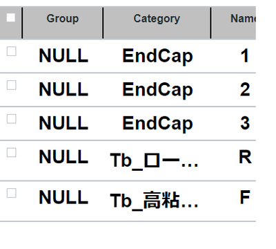

Hi Developers,
Help needs on the title.
we've upgrade TW from ver9.2 to ver 9.3 just before.
after the upgrade, the font style is automatically changed even though I use "Style Theme".
could you let me know how we can stop this change?

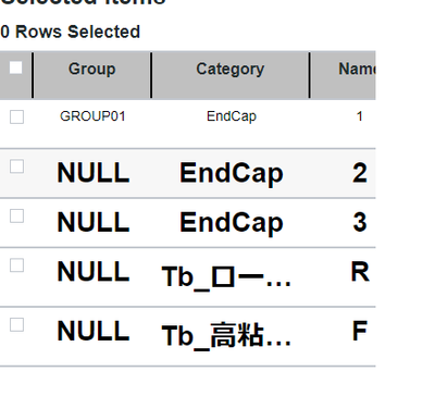

1. font pattern1
2. font pattern2
when I put(update) date with servive, then font style get normal. ( looks same as the one in "Style Theme")

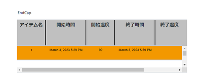

3. font pattern3
when I put long text like datetime, then font size get too small.
context was Text was wrap displayed in TW ver9.2.

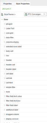

My suggestion would be to look through the grids properties:
And also making sure that your Style Theme hasn't changed.

I found root cause of this issue.
I use "State definition" and all text size of style definitions which are used in the State definition were changed.
I also checked if someone change it or not, but no one changed, thus the trigger of this change is possiblely the TW upgrade to ver9.3
