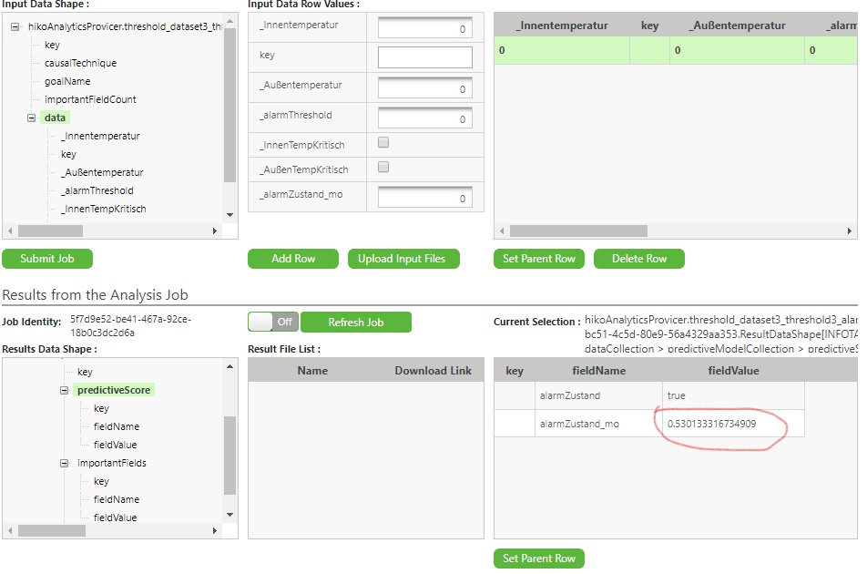

first I want to thank you for your detailed insight, it made the general approach clear to me. So in the case of the sensors, the developers could have used the results of Analytics to raise an alert whenever one of the sensors is nearby a critical value within a threshold of +- x in order to prevent it right?
Another thing I came accross is this webinar called Make your Data Talk! Using Visualizations as an Interface for Intelligence. At 32:46 you see a matrix with the current risk of failure for a specific component (low, medium, high etc).
Do you think they made this categorization based on the marked value on the picture? Is it the probability of the goal being true?

cmorfin
(To:drieder)
Hi Dominik
Regarding this video, I think at 34:10 they give hint on how they built the categories, and yes it based on the model output .

Hello Christophe,
I already wondered what the prediction with time series is about, so now it makes perfectly sense.
Dominik
