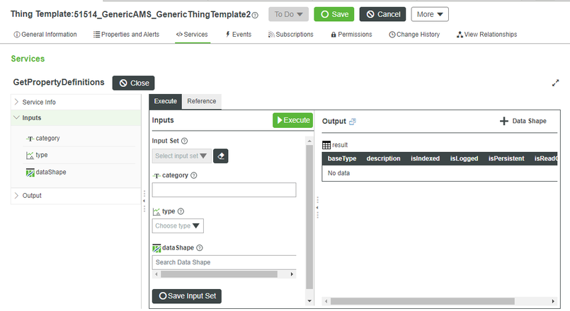

I created a couple of properties in a ThingTemplate and I wanted to retrieve them using the service "GetPropertyDefinations" but there is no data in a result . so how can I retrieve the Property names from ThingTemplate?

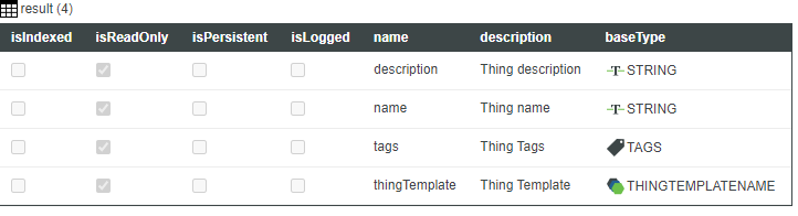

Can you please try
// result: INFOTABLE dataShape: "PropertyDefinition"
let result = ThingTemplates["GenericThing"].GetInstancePropertyDefinitions({
type: undefined /* STRING */

Can you please try

I appreciate the solution provided, but my specific need entails filtering the properties after acquisition, primarily based on their category or multiple base types.
