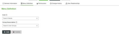

You have to assign group to the menu on the menu definition tab
Hello @DmitryTsarev thank you for your suggestion, in fact, now is working, didn't know it was necessary given that I had already added Run Time to the group at the Permission Tab.
