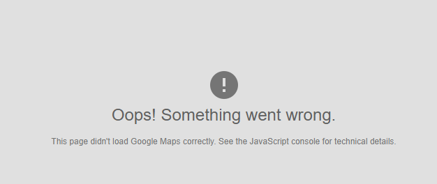

Thank you for your reply. We upgraded to Thingworx 8.4.4 a while ago and the map was working until last week. It stopped over the weekend and I am trying to get to the cause. Below are a screenshot of the errors when saying inspect element, I haven't seen them before and google searched hasn't yielded much results.
At the time of installing the google maps widget on Thingworx 8.3.4 we tried following the new method as described on the developer zone you shared, but it was not compatible with the Thingworx version. We used the old method of placing the API key in the metadata file and it was working like that even after the upgrade. Are you aware of a reason why it would have stopped working over the weekend?
In the past when an issue was related to the API key it was fairly explicit about it in the inspect element error logs.
Thanks for your input.
Looking at your error message makes me think the problem is with something other than the Google Map widget.
The deprecation warning should not cause any problems, but the ERR_NAME_RESOLUTION_FAILED error is not expected behavior and I am not sure where it is coming from.
I tested the stock Google Maps widget v3.0,3 as downloaded from marketplace to see what errors I get with no app key and with an incorrect app key.
No App key at all shows this when I view the mashup
In incorrect app key shows this in the mashup
Neither case showed the error you are seeing in the JS console, but I was testing a simple mashup that only had the map on it. i would download a new copy of the widget from the marketplace and set your key in the ThingWorx UI instead of doing it inside the widget files, then test with a simple mashup.
