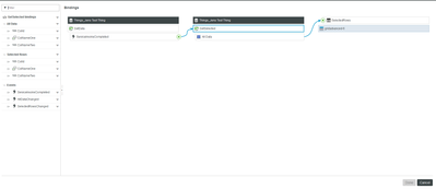

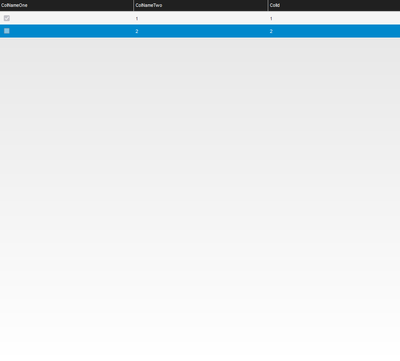

Dear Sharon,
I can give you some background. I have a list of machinegroups that is present on multiple mashups.
when i select a machine group i want it to remember what machinegroup was selected, so when i load a different mashup i can set the selected machinegroup to the previous selected machinegroup.
the above case is just an easy way to test.
Because i am upgrading from thingworx 9.0.3 to 9.3.3, and all existing pages use the advanced grid widget(now deprecated). when upgrading to the Grid widget, the selection proces doesn't work.
i will add some pictures to illustrate.
case 1 is the old advanced grid widget

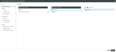

case 2 is the new grid widget
Jens

He @slangley,
depends on the mashup, but i already excluded part of the problem in the testfile that i send.
The problem isn't that i don't get the right one selected. The problem is that i cant select any at all.
as shown in the testfile:
This is the Infotable with bound to all:
var result = DataShapes['testJens'].CreateValues();
result.AddRow({
ColNameOne : true,
ColNameTwo : 1,
ColId:1
result.AddRow({
ColNameOne : false,
ColNameTwo : 2,
ColId:2
this is bound to SelectedRows:
result.AddRow({
ColNameOne : false,
ColNameTwo : 2,
ColId:2
//i only set the id field usually. but wanted to test if it had to match for 100%.
this works with the (legacy)advanced grid widget.
It selects the second row.
But the Grid widget just doesn't select anything.it just gives me this error:
09:35:56 ERROR - Runtime exception handling data update for binding {"Id":"097e2722-4c44-48f8-babd-0eaa37bbd51e","PropertyMaps":[{"SourceProperty":"","SourcePropertyBaseType":"INFOTABLE","SourcePropertyType":"InfoTable","TargetProperty":"SelectedRows","TargetPropertyBaseType":"INFOTABLE","TargetPropertyType":"property"}],"SourceArea":"Data","SourceDetails":"AllData","SourceId":"GetSelected","SourceSection":"Things_Jens Test Thing","TargetArea":"UI","TargetId":"ptcsgrid-8","TargetSection":"","isBoundToSelectedRows":false,"nEntries":1}
Exception: this.updateSelectedRowsProperty is not a function on line number 1 in file mashup-common-widgets-runtime.js?_v=9.3.3
I also made a support case for this. This must be a bug.
SelectedRows just doesn't select anything.
