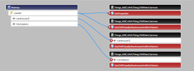

I have a "navigation page" that needs to update a grid on a new mashup that loads when my navigation button is pressed and two items are selected from my drop down and combo box lists.
My navigation button will upload the next correct mashup however my grid is not being filled with any info based on selected items from my drop down lists.
bindings for grid widgetbindings for grid widgetmashup bindings for navigation page mashupmashup bindings for navigation page mashup

We aren't able to tell what your services are doing from the information provided, but we would recommend using session parameters or mashup parameters for moving data from one mashup to the next.  Mashup parameters will become a bindable target on the navigation widget once you specify the mashup to navigate to.

Okay, so I need a grid on a mashup to update with data based on the two selected items from the dropdown on a different mashup. My service is called GETDMRDataByWarehouseAndWorkStation as shown below in WAREHOUSE.PNG. Mashup bindings also included. Grid bindings included (grod)
Not sure why there is no info is updating my grid when I choose a warehouse and workstation from other mashup

Hello @slangley
I figured it out! Thanks for the suggestion. One of my bindings was incorrect and I needed to add two parameters to my mashup.My problem now is figuring out how to highlight and keep a grid row highlighted when a button is pressed and then un-highlight the row when a different button is pressed.
