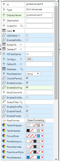

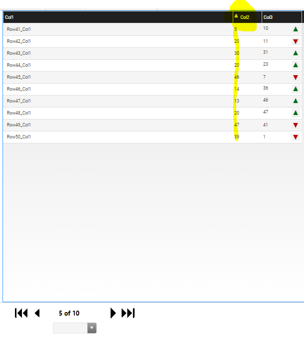

I am currently working with gridadvance widget (8.1 TW version), and I want to being able to sort each column.
I defined my datashape, bind my data into the grid, etc. But when I go under my widget's properties, I select EnableSorting and run it.
Unfortunately when I try to sort the column (number type), the table header shows me that its trying to sort (triangles are showed), but the the rows does not get sort.
Am I skipping any step or there is a problem with this widget?
I appreciate any help

Hi Vibhuti,
  1. I checked my logs and there is not issue
  2. Attached:
    • The grid during running time and after click the column header to trigger sort
    • Properties of grid: 'EnableSorting' selected
  3. Advance Grid Widget, Package Version 4.2.0

Hi Aovalle,
The filtering of an advanced Advanced Grid column is not done on the client (unlike the out of the box Grid widget)
You have to query again the data using the QueryFilter property that is build when you click on a column header.
See Advanced Grid Widgets Extension guide -  Implement Filtering
