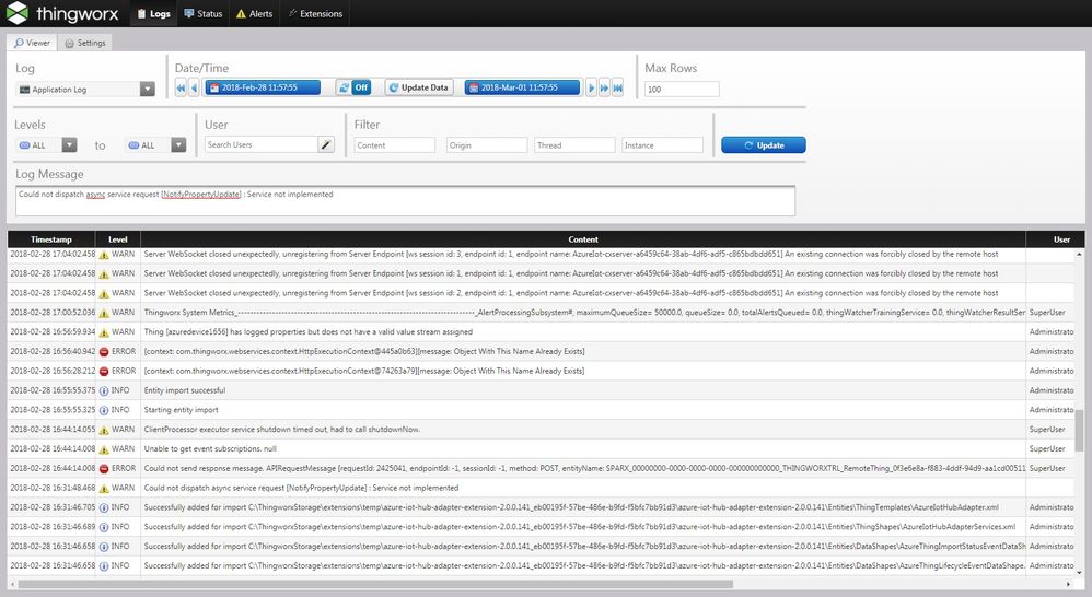

these more information is when I just launch the Azhre IOT Hub Connector( still not run the edge demo), the TWX report a issue:Could not dispatch async service request [NotifyPropertyUpdate] : Service not implemented. more detail please reference the attachment.New Bitmap Image.jpg
