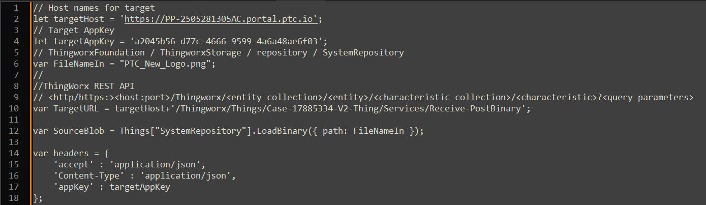

Hello @Janaki.Raman ,
Here is some code. This is a ThingWorx Service which  is sending a file to another ThingWorx environment:
Let me know if this is helpful. I will look to see if I have a save Binary or other operations
