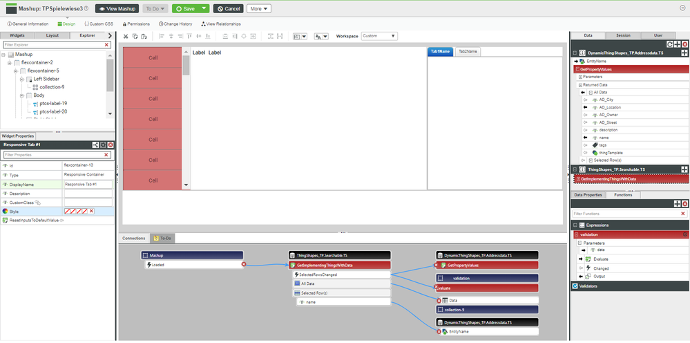

I am having a mashup with a List of different Things (Shape.ImplementingThings) and a Tab-Widget.
Now I want to hide Tab1 when the selected Thing is not implementing a specific Shape.
I tried to put a Value from a dynamic GetProperty datasource to a validator widget and put the output to visibility of the tab. I checked the "name" property against null and undefined, but it was always true.
Is there any possibility to get a boolean for a dynamic thing if it does not implement a specific shape?

My current approach was like this:
So when I select a thing which implements the thingshape "Searchable.TS" the evaluation of an expression/validation gets triggered, which gehts the "name" property of a "Addressdata.TS" Shape - GetPropertyValues function.
So when I select a thing, the dynamic GetPropertyValues should get called. When the selected thing hasn't implemented the address shape the result should be null, correct? So when I than put an property of the non existing result to an expression, i should compare to null or undefined to set visibility.
if(data && data !== null && data != 'undefined');
But this returns true always.
