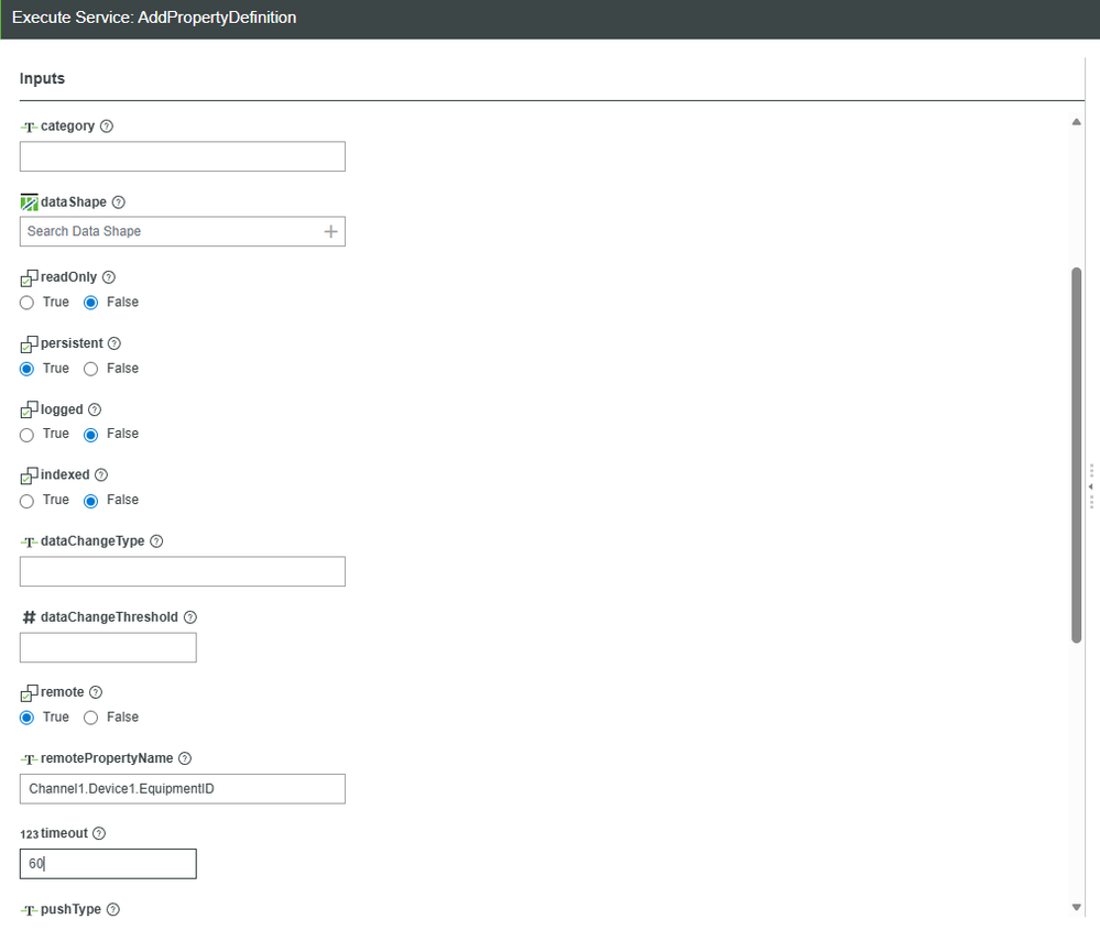

I've created an Industrial Thing with a Kepware connection. I want to create an application where adding and binding properties will be done from code without using Composer.

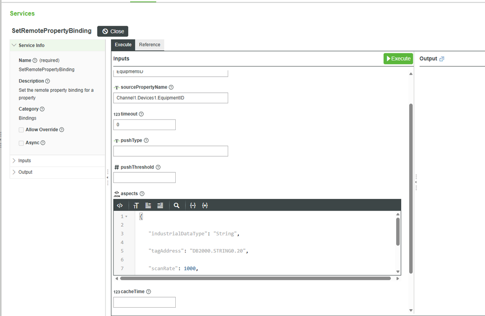

I tried to connect the ready properties with remote bind using the service SetRemotePropertyBinding
JK_10565232_0-1762511972802.pngWithout success.
I tried to create a new property using AddPropertyDefinition and it also didn't work.
my aspcect json looks like that :
"industrialDataType": "String",
"tagAddress": "DB2000.STRING0.20",
"scanRate": 1000,
"tagType": "Static",
"readOnly": "true"
Where I did something wrong?

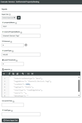

I tried following.. It's working fine.
The Kepware tag path is "Channel1.Device1.Tag1"
  1. Created Thing Property called "TEST" as STRING base type.
  2. Executed "SetRemotePropertyBinding()" service and passed following parameters.
      "propertyName": "TEST",
      "sourcePropertyName": "Channel1.Device1.Tag1",
      "timeout": "0",
      "pushType": "VALUE",
      "pushThreshold": "0",
      "aspects": {
        "industrialDataType": "Word",
        "tagAddress": "Channel1.Device1.Tag1",
        "scanRate": 1000,
        "startType": "readEdgeValue",
        "source": "",
        "dataShape": ""
Hello Sathishkumar_C
Thank you for your answer. What kind of TW version are you using?
I tried it in 10.0.1
I have TWX 9.3 and its not working still. Maybe I should change something in platform settings json?
I tried the same with TWX 10.0.1 and its not working too. I did something wrong before. Did you set up your properties TEST like remote properties before you executed Set Property Binding Service?
