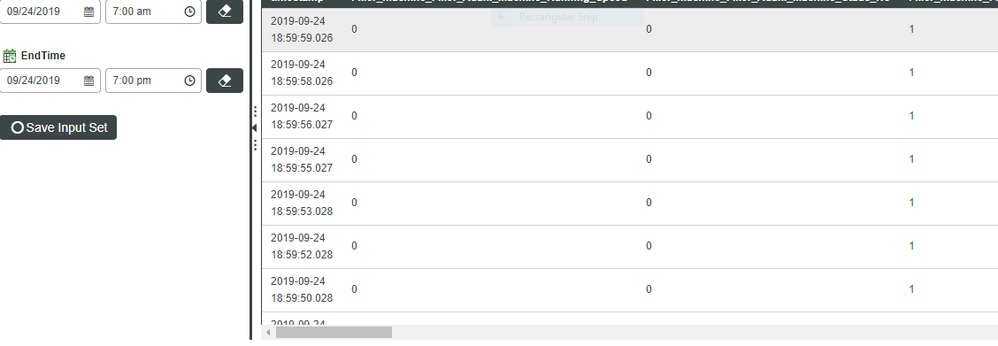

I have an infotable with nearly 1000 entries and the column headers are named as Timestamp, Field1, Field2, Field3, Field4, Field5, Field6, Field7, Field8, Field9, Field10. My requirement is that: If Field2, Field4 and Field6 are having the same value (say 0), it should fetch the time when all the 3 fields turned 0. Also, it should calculate the duration of how long all the 3 fields were in same value state. I will attach a screenshot showing the sample infotable with values. Please provide a solution for this usecase. Thanks in advance.
Thanks in Advance,
Gurudev

We tried out this approach. But, we are getting "No data" in the resultant infotable.
What might have gone wrong? But there are fields in our table with similar values.
Also, we would like to add
Field1 is taking integer value(0 or1)
Field2 is taking Boolean value (true or false)
Field3 is taking again integer value (0 or 1).
So do we need to change the filter again that matches with the base type of each field name?
Thank you.

Hi @Janakiraman-P ,
Please find the below code snippet and please let us know why it didn't work.
var query = {
"filters": {
"type": "AND",
"filters": [
"fieldName": "IntegerProperty1",
"type": "EQ",
"value": "0"
"fieldName": "BooleanProperty2",
"type": "EQ",
"value": "false"
"fieldName": "BooleanProperty3",
"type": "EQ",
"value": "false"
"fieldName": "IntegerProperty4",
"type": "EQ",
"value": "0"
var infot = Things["MyThing"].QueryPropertyHistory({
maxItems: undefined /* NUMBER */,
startDate: StartTime /* DATETIME */,
endDate: EndTime /* DATETIME */,
oldestFirst: undefined /* BOOLEAN */,
query: query /* QUERY */
var param = {
t: infot /* INFOTABLE */,
result = Resources["InfoTableFunctions"].Query(param);
Thanks in advance.
