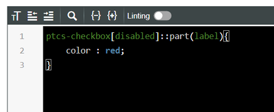

Hi @AC_10460579
Try below code
ptcs-checkbox[disabled]::part(label){
    color : red;
/VR
Not working

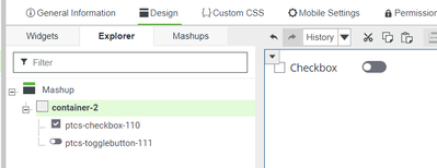

Hi @AC_10460579
Could you please upload some screenshot
