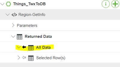

When you look at your service in the mashup builder and expand alldata or selectedrow(s) do you see all the field names (columns)?
You may have to remove the service and re-add the service if you had it initially mapped to the mashup without a datashape and added it afterwards
Question: When you look at your service in the mashup builder and expand alldata or selectedrow(s) do you see all the field names (columns)?
Answer: No, I dont see any field name.
As per your suggestion i have tried the same and also tried to create new service with new datashape, but still facing same issue.
