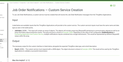

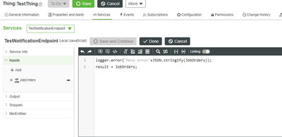

I created a Job Order Notification service according to this instruction and I assigned in PTC.FSU.CORE.JobOrder.Endpoint_TG. When should this Job Order Notification be called? How can I check if this service is called and get its result?
I am using Thingworx 9.3.9.

You asked a very similar question here, where I gave the answer earlier today.
I think the other post contains the answers, mostly about validating that the subscriptions are active and the configuration steps (where you have to name the service in Configuration tab and execute a service).
Let me know if you need more help on this one.
