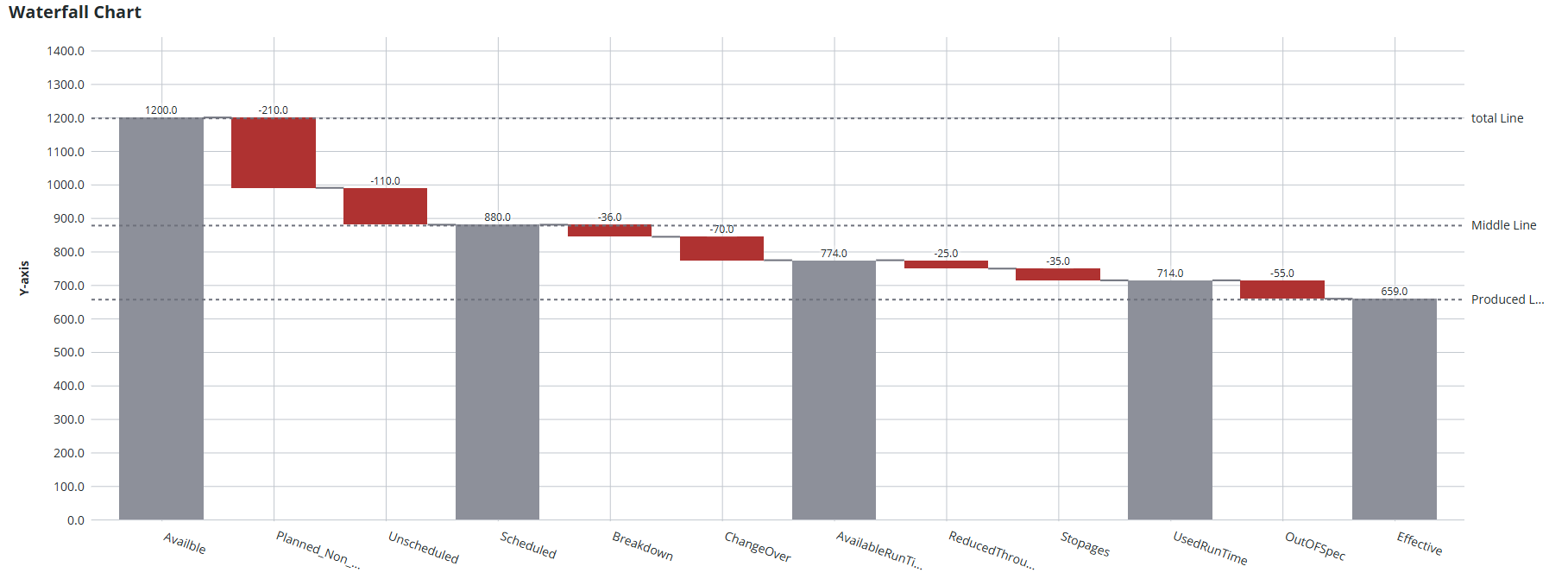

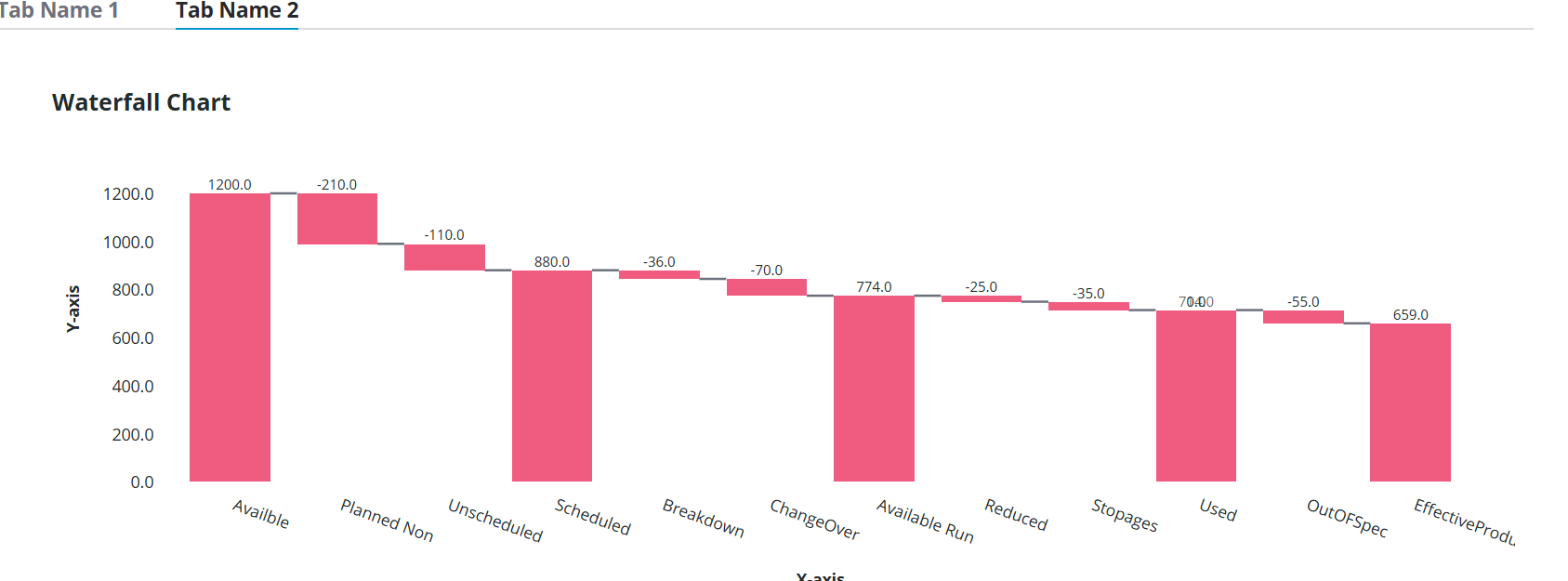

Hello All.
I really would like to have view like OEE Bridge.
I was trying to use Waterfall widget but finall resuld doesn t looks like OEE bridge.
Can I find any custom widget to handle this problem?
I would like have something like this
 but I have like this one
I set up Total like ShowTotal : true and Effecitve time looks like that:
Category: 'Effective Time', // STRING
Amount: undefined ,
ShowTotal: false// STRING

Hello @JK_10565232 ,
I took a look at the issue and created my own test data. There are some problems but is this what you are going for?
Here is the test data I was providing:

Beware that it will not be possible always to have an 100% identical view to what you pasted in the original post.
You should approach it in the following way:
  1. Perform a gap analysis and see if you can bypass it by creatively using the standard platform widgets and displaying the data differently. It's really important to make a correct analysis (make really sure you're using all of a widget capabilities), as @PEHOWE is doing.
  2. If you need 100% identical view, you will need to create a custom widget (Help Center link here). Note that this involved client-side Javascript knowledge which typically is not that observed in projects. For example I am familiar with widget building, but each time when the situation asks for this I try really hard to tweak the requirements to choose option 1 (it's just more work).
I took another try at the chart. Here is what I have. Let me know if you have any questions
