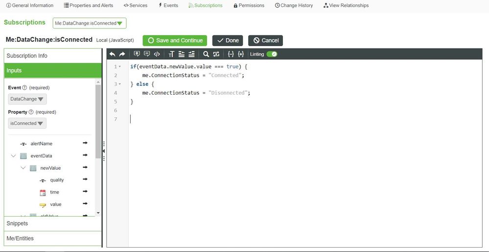

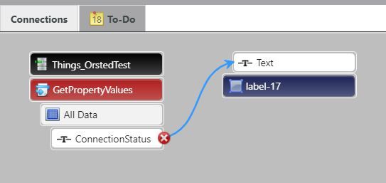

I have tried to create a simple subscription (see script and picture below) with the if/else statement, but when the mashup is loaded the label is not visible with any of the texts. I used the GetPropertyValue service and bound the ConnectionStatus string to the label-widget.
Am I missing anything or writing the script/statements wrong? (eg the booleans false/true value) Or is there a better way to achieve this?

if(eventData.newValue.value === true) {
    me.ConnectionStatus = "Connected";
} else {
    me.ConnectionStatus = "Disonnected";
6 REPLIES 6
Try GetProperties instead, and check the box "Automatically update values when able" that why the connection status will update "automagically" when it connects/disconnects. Also remember to trigger the GetProperties service at Mashup Loaded or alike.

Thanks for your reply Charles,
I have triggered the Mashup Loaded and tried to use GetProperties instead, but no text is shown here as well...
I also tried to bind the boolean "isConnected" to the label widget instead, which then shows the text "false".
But I want it in this case to be "disconnected", and that is why I created the script using the string ConnectedStatus, which should be bound instead. But when doing so the label is empty

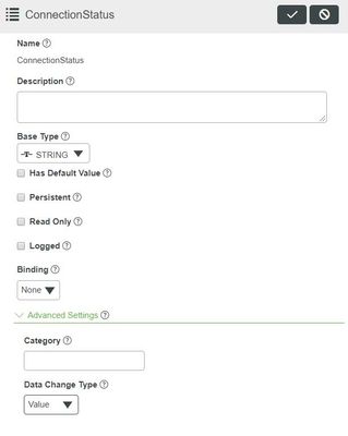

ConnectionStatus changes when isConnected changes? I mean seeing it from the composer? I that's true, then which it's the ValueChange policy on ConnectionStatus it's set to VALUE?
miwhow
3-Newcomer
(To:CarlesColl)
Yes, the purpose is that ConnectionStatus should change, when isConnected changes - but this doesn't happen now...
If I have understood it correct, then yes, the ConnectionStatus' Data Change Type is set to VALUE (see picture below)
Hello @miwhow,
Sorry for a stupid question, but did you enable this subscription? They are disabled by default.
/ Constantine
Yes, I have enabled the subscription - but thanks for the reminder
